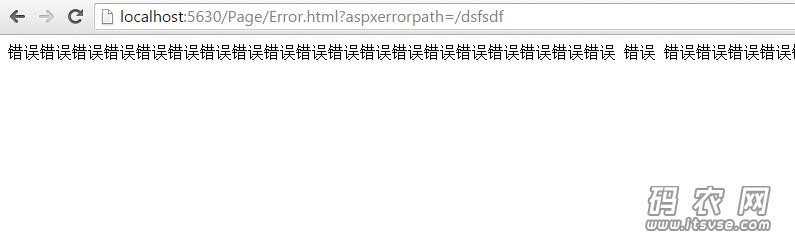

  1. <system.web>
  2.     <customErrors mode="On" defaultRedirect="/Page/Error.html">
  3.       <error statusCode="404" redirect="/Page/Error.html" />
  4.     </customErrors>
  5. </system.web>
