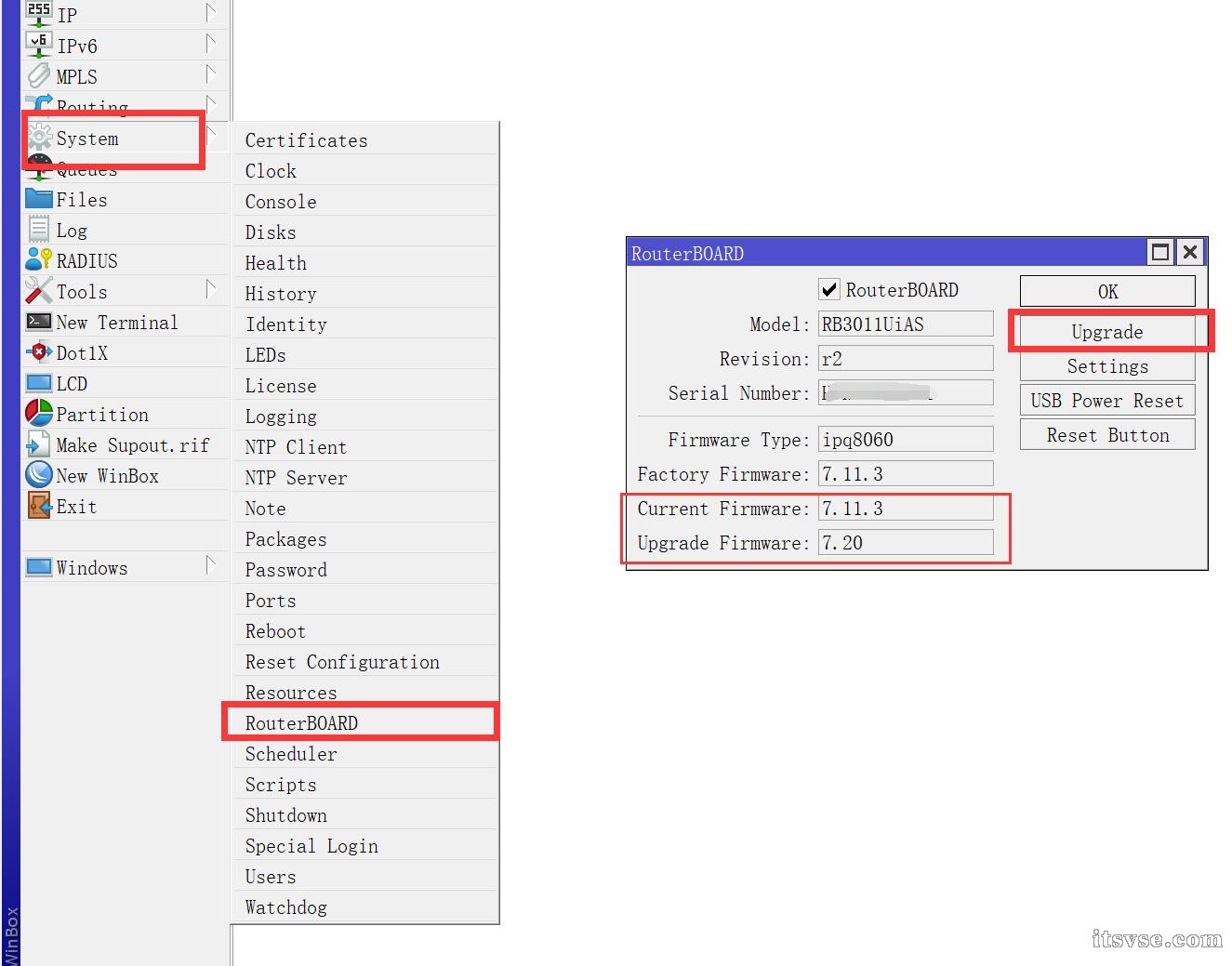

通过 Winbox 界面化升级,找到 System -> RouterBOARD -> Upgrade 操作,如下图:

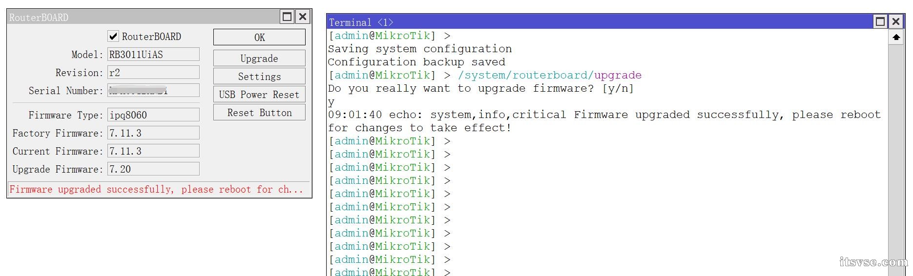

通过 Terminal 命令行升级,命令如下:
system,info,critical Firmware upgraded successfully, please reboot
for changes to take effect!
升级完成后,需要重启系统!!!
