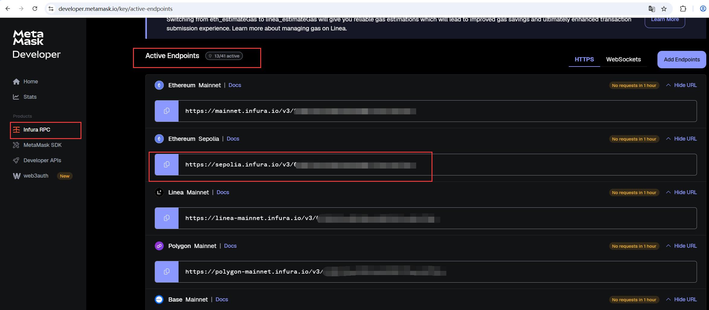

Infura 接口
如果不想同步区块链数据,可以调用第三方接口查询区块链的数据。注册 Infura 账户,获取接口地址。

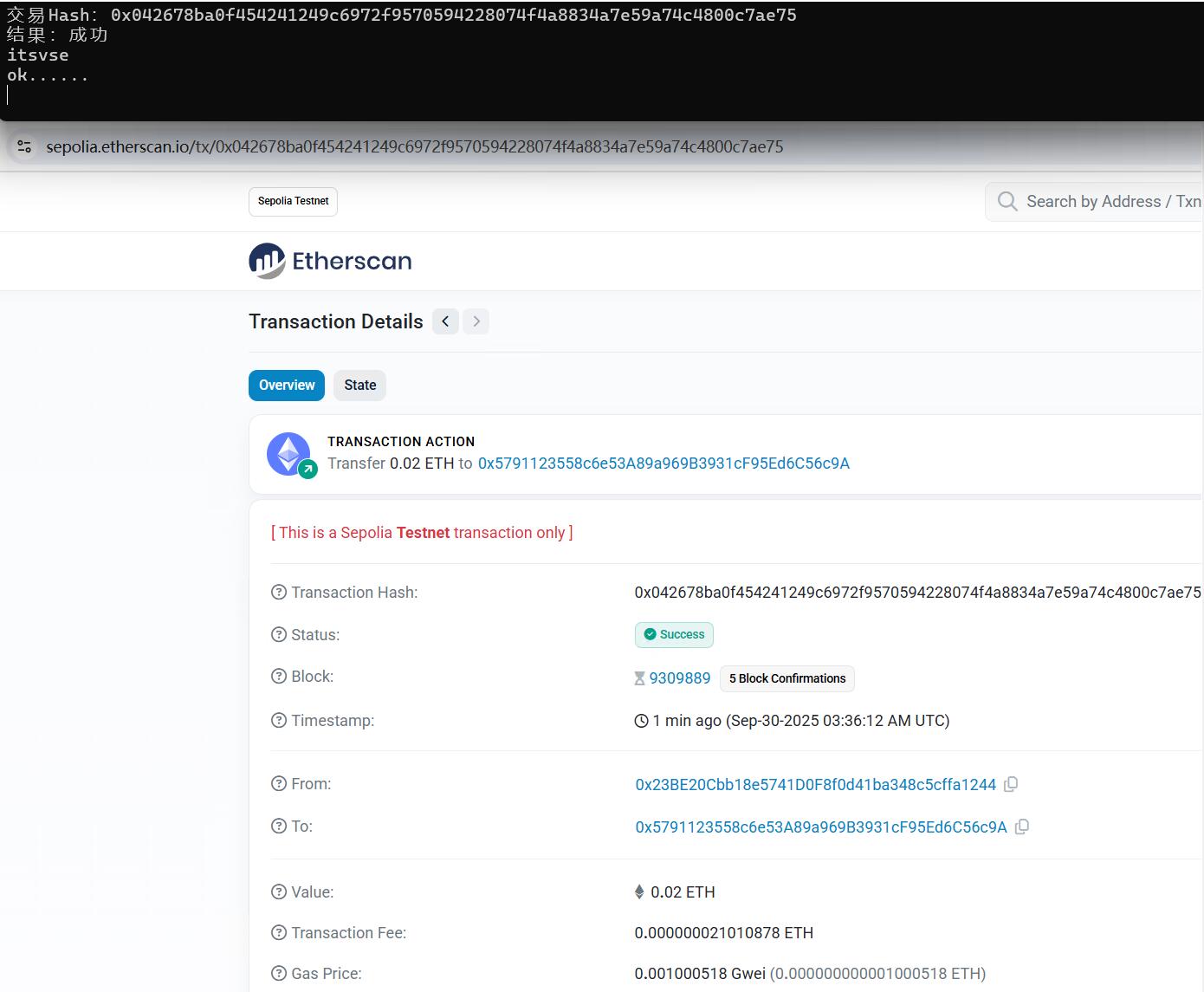

使用钱包一转账 0.02 ether 给钱包二。代码如下:
转账成功地址:超链接登录可见。

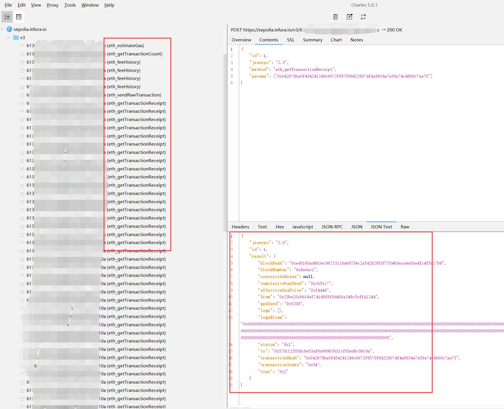

使用 Charles 抓包如下:
eth_estimateGas
        "id": 1,
        "jsonrpc": "2.0",
        "method": "eth_estimateGas",
        "params": [{
                "from": "0x23BE20Cbb18e5741D0F8f0d41ba348c5cffa1244",
                "to": "0x5791123558c6e53A89a969B3931cF95Ed6C56c9A",
                "value": "0x470de4df820000"
eth_feeHistory
        "id": 1,
        "jsonrpc": "2.0",
        "method": "eth_feeHistory",
        "params": ["0x64", "latest", []]
eth_sendRawTransaction
        "id": 1,
        "jsonrpc": "2.0",
        "method": "eth_sendRawTransaction",
        "params": ["0x02f87283aa36a701830f425b830f447d825208945791123558c6e53a89a969b3931cf95ed6c56c9a87470de4df82000080c080a0691c04859a5b7497208752bc14d7f7a14e2459db4c9c760678b6a345c7022342a01e3c193ad6604940f7724fec0d6db9ba0837fb1feeca7f5829ce687f9e41e14c"]
eth_getTransactionReceipt
        "id": 1,
        "jsonrpc": "2.0",
        "method": "eth_getTransactionReceipt",
        "params": ["0x042678ba0f454241249c6972f9570594228074f4a8834a7e59a74c4800c7ae75"]
