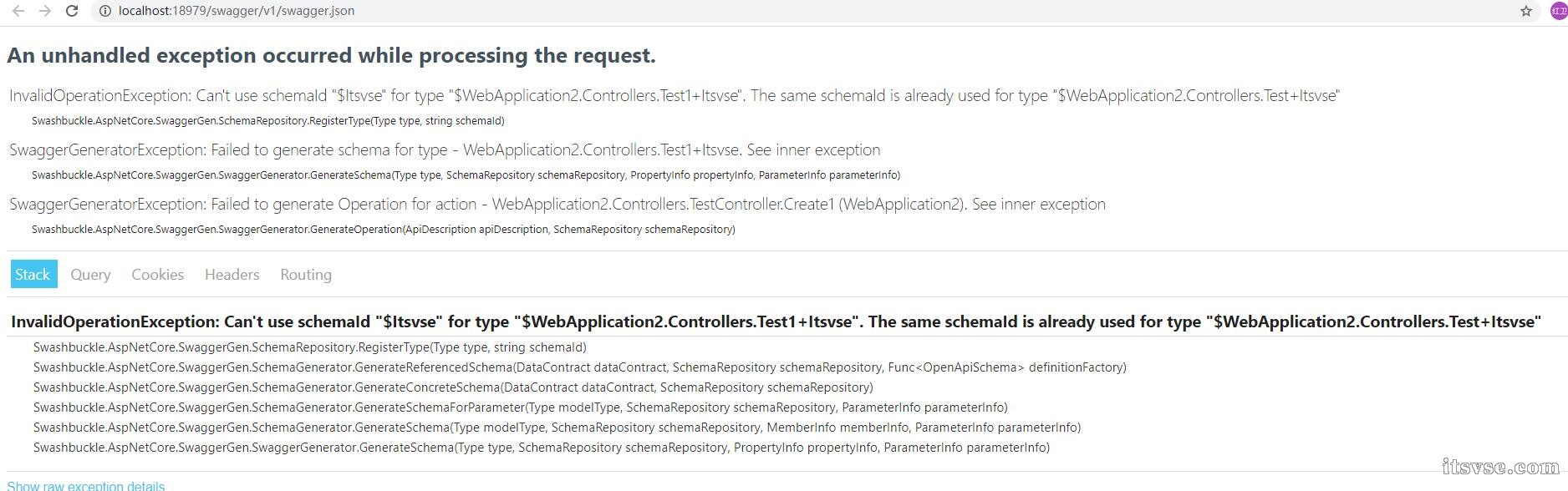

Can't use schemaId xx for type xx. The same schemaId is already used for type xx
InvalidOperationException: Can't use schemaId "$Itsvse" for type "$WebApplication2.Controllers.Test1+Itsvse". The same schemaId is already used for type "$WebApplication2.Controllers.Test+Itsvse"
错误原因:

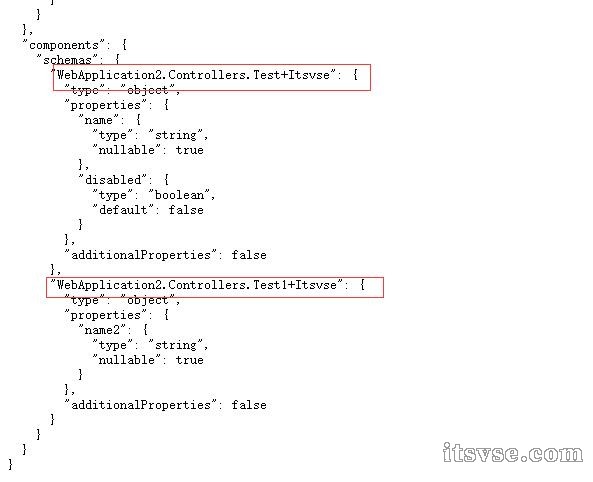

在项目中有请求参数、响应参数有相同的对象名,但是处于不用的命名空间,示例错误代码如下:
"components": {
    "schemas": {
      "Itsvse": {
        "type": "object",
        "properties": {
          "name": {
            "type": "string",
            "nullable": true
          "disabled": {
            "type": "boolean",
            "default": false
        "additionalProperties": false
      "Itsvse1": {
        "type": "object",
        "properties": {
          "name2": {
            "type": "string",
            "nullable": true

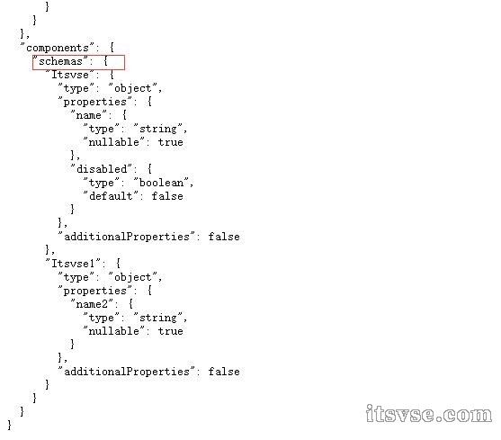

解决方案
services.AddSwaggerGen 设置如下代码:
