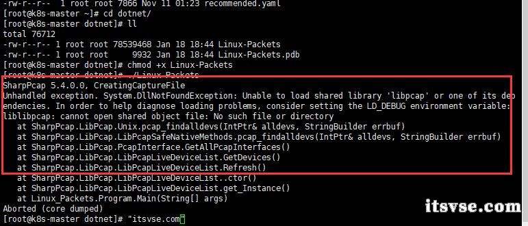

将项目发布到 Linux 服务器上面(发布一定不要设置生成单文件!!!发布一定不要设置生成单文件!!!发布一定不要设置生成单文件!!!),报错如下:
SharpPcap 5.4.0.0, CreatingCaptureFile
Unhandled exception. System.DllNotFoundException: Unable to load shared library 'libpcap' or one of its dependencies. In order to help diagnose loading problems, consider setting the LD_DEBUG environment variable: liblibpcap: cannot open shared object file: No such file or directory
   at SharpPcap.LibPcap.Unix.pcap_findalldevs(IntPtr& alldevs, StringBuilder errbuf)
   at SharpPcap.LibPcap.LibPcapSafeNativeMethods.pcap_findalldevs(IntPtr& alldevs, StringBuilder errbuf)
   at SharpPcap.LibPcap.PcapInterface.GetAllPcapInterfaces()
   at SharpPcap.LibPcap.LibPcapLiveDeviceList.GetDevices()
   at SharpPcap.LibPcap.LibPcapLiveDeviceList.Refresh()
   at SharpPcap.LibPcap.LibPcapLiveDeviceList..ctor()
   at SharpPcap.LibPcap.LibPcapLiveDeviceList.get_Instance()
   at Linux_Packets.Program.Main(String[] args)
Aborted (core dumped)
报错原因是因为服务器没有安装 libpcap,服务器系统:CentOS Linux release 8.2.2004 (Core)

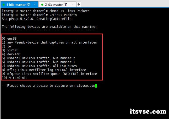

记得程序需要赋予执行权限,然后再运行,如下:
程序可以正常在Linux下运行了,如下图:
