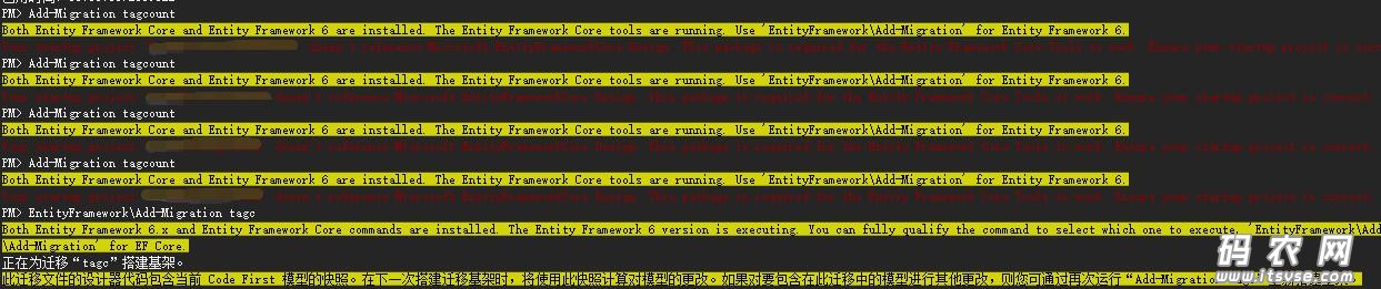

Your startup project 'XXX' doesn't reference Microsoft.EntityFrameworkCore.Design. This package is required for the Entity Framework Core Tools to work. Ensure your startup project is correct, install the package, and try again.
在执行命令的时候,最下面有个黄色提示,如下:
Both Entity Framework Core and Entity Framework 6 are installed. The Entity Framework Core tools are running. Use 'EntityFramework\Add-Migration' for Entity Framework 6.
实体框架核心和实体框架6都已安装。 实体框架核心工具正在运行。 为Entity Framework 6使用“EntityFramework \ Add-Migration”。
解决办法:
Both Entity Framework 6.x and Entity Framework Core commands are installed. The Entity Framework 6 version is executing. You can fully qualify the command to select which one to execute, 'EntityFramework\Add-Migration' for EF6.x and 'EntityFrameworkCore\Add-Migration' for EF Core.
安装了Entity Framework 6.x和Entity Framework Core命令。 Entity Framework 6版本正在执行。 您可以完全限定命令以选择要执行的命令,EF6.x的“EntityFramework \ Add-Migration”和EF Core的“EntityFrameworkCore \ Add-Migration”。
